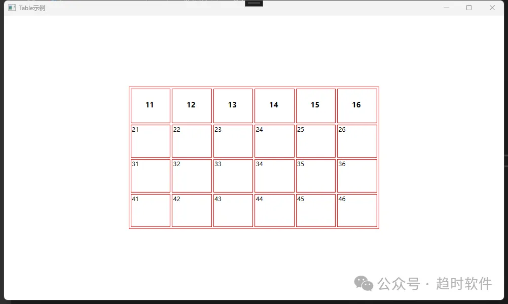

四、运行效果
4.1 默认效果
<qs:Table
    Width="50%"
    Height="50%"
    Align="Center"
    Border="1 solid red"
    Valign="Middle">
    <qs:Tr>
        <qs:Th>11</qs:Th>
        <qs:Th>12</qs:Th>
        <qs:Th>13</qs:Th>
        <qs:Th>14</qs:Th>
        <qs:Th>15</qs:Th>
        <qs:Th>16</qs:Th>
    </qs:Tr>
    <qs:Tr>
        <qs:Td>21</qs:Td>
        <qs:Td>22</qs:Td>
        <qs:Td>23</qs:Td>
        <qs:Td>24</qs:Td>
        <qs:Td>25</qs:Td>
        <qs:Td>26</qs:Td>
    </qs:Tr>
    <qs:Tr>
        <qs:Td>31</qs:Td>
        <qs:Td>32</qs:Td>
        <qs:Td>33</qs:Td>
        <qs:Td>34</qs:Td>
        <qs:Td>35</qs:Td>
        <qs:Td>36</qs:Td>
    </qs:Tr>
    <qs:Tr>
        <qs:Td>41</qs:Td>
        <qs:Td>42</qs:Td>
        <qs:Td>43</qs:Td>
        <qs:Td>44</qs:Td>
        <qs:Td>45</qs:Td>
        <qs:Td>46</qs:Td>
    </qs:Tr>
</qs:Table>

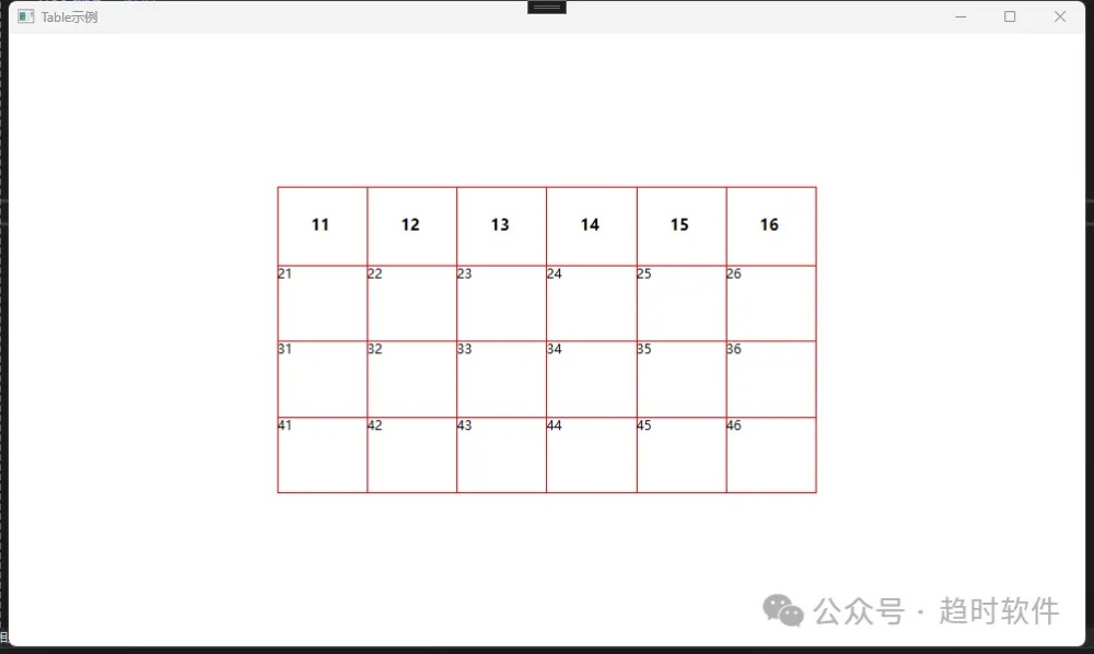

4.2 合并相邻的线
<qs:Table
    Width="50%"
    Height="50%"
    Align="Center"
    Border="1 solid red collapse"
    Valign="Middle">
    <qs:Tr>
        <qs:Th>11</qs:Th>
        <qs:Th>12</qs:Th>
        <qs:Th>13</qs:Th>
        <qs:Th>14</qs:Th>
        <qs:Th>15</qs:Th>
        <qs:Th>16</qs:Th>
    </qs:Tr>
    <qs:Tr>
        <qs:Td>21</qs:Td>
        <qs:Td>22</qs:Td>
        <qs:Td>23</qs:Td>
        <qs:Td>24</qs:Td>
        <qs:Td>25</qs:Td>
        <qs:Td>26</qs:Td>
    </qs:Tr>
    <qs:Tr>
        <qs:Td>31</qs:Td>
        <qs:Td>32</qs:Td>
        <qs:Td>33</qs:Td>
        <qs:Td>34</qs:Td>
        <qs:Td>35</qs:Td>
        <qs:Td>36</qs:Td>
    </qs:Tr>
    <qs:Tr>
        <qs:Td>41</qs:Td>
        <qs:Td>42</qs:Td>
        <qs:Td>43</qs:Td>
        <qs:Td>44</qs:Td>
        <qs:Td>45</qs:Td>
        <qs:Td>46</qs:Td>
    </qs:Tr>
</qs:Table>

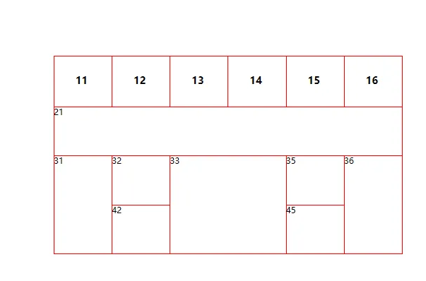

4.3 合并单元格
<qs:Table
    Width="50%"
    Height="50%"
    Align="Center"
    Valign="Middle">
    <qs:Tr>
        <qs:Th>11</qs:Th>
        <qs:Th>12</qs:Th>
        <qs:Th>13</qs:Th>
        <qs:Th>14</qs:Th>
        <qs:Th>15</qs:Th>
        <qs:Th>16</qs:Th>
    </qs:Tr>
    <qs:Tr>
        <qs:Td ColSpan="6">21</qs:Td>
    </qs:Tr>
    <qs:Tr>
        <qs:Td RowSpan="2">31</qs:Td>
        <qs:Td>32</qs:Td>
        <qs:Td ColSpan="2" RowSpan="2">33</qs:Td>
        <qs:Td>35</qs:Td>
        <qs:Td RowSpan="2">36</qs:Td>
    </qs:Tr>
    <qs:Tr>
        <qs:Td>42</qs:Td>
        <qs:Td>45</qs:Td>
    </qs:Tr>
</qs:Table>

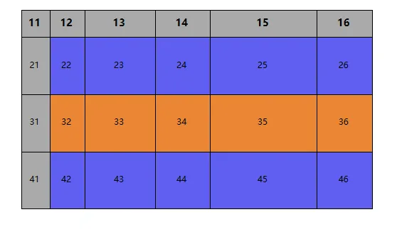

4.4 综合案例
<qs:Table
       Width="50%"
       Height="50%"
       Align="Center"
       Border="1 solid Black collapse"
       Valign="Middle">
    <qs:Tr
           Height="40"
           Align="Center"
           BgColor="#FFAAAAAA"
           Valign="Middle">
        <qs:Th Width="40" BgColor="#FFAAAAAA">11</qs:Th>
        <qs:Th Width="10%">12</qs:Th>
        <qs:Th>13</qs:Th>
        <qs:Th>14</qs:Th>
        <qs:Th>15</qs:Th>
        <qs:Th>16</qs:Th>
    </qs:Tr>
    <qs:Tr
           Height="30%"
           Align="Center"
           BgColor="#FF5F5FF1"
           Valign="Middle">
        <qs:Td BgColor="#FFAAAAAA">21</qs:Td>
        <qs:Td>22</qs:Td>
        <qs:Td Width="20%">23</qs:Td>
        <qs:Td>24</qs:Td>
        <qs:Td>25</qs:Td>
        <qs:Td>26</qs:Td>
    </qs:Tr>
    <qs:Tr
           Height="30%"
           Align="Center"
           BgColor="#FFEA8633"
           Valign="Middle">
        <qs:Td BgColor="#FFAAAAAA">31</qs:Td>
        <qs:Td>32</qs:Td>
        <qs:Td>33</qs:Td>
        <qs:Td>34</qs:Td>
        <qs:Td>35</qs:Td>
        <qs:Td>36</qs:Td>
    </qs:Tr>
    <qs:Tr
           Height="30%"
           Align="Center"
           BgColor="#FF5F5FF1"
           Valign="Middle">
        <qs:Td BgColor="#FFAAAAAA">41</qs:Td>
        <qs:Td>42</qs:Td>
        <qs:Td>43</qs:Td>
        <qs:Td>44</qs:Td>
        <qs:Td Width="150">45</qs:Td>
        <qs:Td>46</qs:Td>
    </qs:Tr>
</qs:Table>

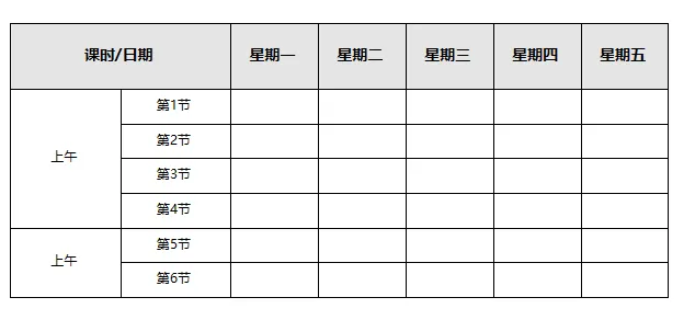

4.5 课表
<qs:Table
    Width="600"
    Height="250"
    Align="Center"
    Border="1 solid black collapse"
    Valign="Middle">
    <qs:Tr
        Height="60"
        Align="Center"
        BgColor="#FFE5E5E5"
        Valign="Middle">
        <qs:Th ColSpan="2">
            <TextBlock Text="课时/日期" />
        </qs:Th>
        <qs:Th>星期一</qs:Th>
        <qs:Th>星期二</qs:Th>
        <qs:Th>星期三</qs:Th>
        <qs:Th>星期四</qs:Th>
        <qs:Th>星期五</qs:Th>
    </qs:Tr>
    <qs:Tr Align="Center" Valign="Middle">
        <qs:Td RowSpan="4">上午</qs:Td>
        <qs:Td Width="100">第1节</qs:Td>
        <qs:Td />
        <qs:Td />
        <qs:Td />
        <qs:Td />
        <qs:Td />
    </qs:Tr>
        <qs:Td>第2节</qs:Td>
        <qs:Td />
        <qs:Td />
        <qs:Td />
        <qs:Td />
        <qs:Td />
    </qs:Tr>
        <qs:Td>第3节</qs:Td>
        <qs:Td />
        <qs:Td />
        <qs:Td />
        <qs:Td />
        <qs:Td />
    </qs:Tr>
        <qs:Td>第4节</qs:Td>
        <qs:Td />
        <qs:Td />
        <qs:Td />
        <qs:Td />
        <qs:Td />
    </qs:Tr>
        <qs:Td RowSpan="2">上午</qs:Td>
        <qs:Td Width="100">第5节</qs:Td>
        <qs:Td />
        <qs:Td />
        <qs:Td />
        <qs:Td />
        <qs:Td />
    </qs:Tr>
        <qs:Td>第6节</qs:Td>
        <qs:Td />
        <qs:Td />
        <qs:Td />
        <qs:Td />
        <qs:Td />
    </qs:Tr>
</qs:Table>
