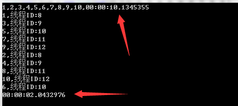

 5.Parallel
最后说一下在循环中开启多线程的简单方法:
Stopwatch watch1 = new Stopwatch();
watch1.Start();
    for (int i = 1; i <= 10; i++)
    Console.Write(i + ",");
    Thread.Sleep(1000);
watch1.Stop();
Console.WriteLine(watch1.Elapsed);
Stopwatch watch2 = new Stopwatch();
watch2.Start();
//会调用线程池中的线程
Parallel.For(1, 11, i =>{
Console.WriteLine(i + ",线程ID:" + Thread.CurrentThread.ManagedThreadId);
Thread.Sleep(1000);});
watch2.Stop();
Console.WriteLine(watch2.Elapsed);
运行结果:
